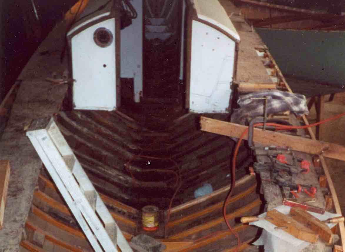

McGinn’s friend Guy Hupy, an architectural designer who had crewed for McGinn on a number of races, offered to buy into the boat as a partner in order to help do a much-needed rebuild. As a veteran racer, he could tell that the boat had great lines – and deserved to be saved. He convinced McGinn that it was time to get the boat out of the water for a major restoration effort. With SPARKLE hauled out for three years at the Point Hudson Boat Shop in Port Townsend, the co-owners worked evenings and weekends to replace frames, floors, stem, and cabin sole, put on a new deck, and rebuild the cockpit.
IMG SPARKLE restore 1 deck
They discovered that, due to deteriorating fastenings, many of the floors were no longer attached to the hull and pulled right off in their hands. As Hupy puts it, “What held this boat together? Memory?”
They drilled out and put in new fastenings where possible. Some were so badly corroded that they just plugged them and put in new ones. A new rudder was built to replace the one that had floated away on that first ill-fated trip. McGinn, who was by now working as a rigger at Port Townsend Rigging, added new standing and running rigging. All the old rusty fastenings meant it was impossible to keep the white topsides clean, so they painted the boat black.
Deciding that they wanted to have her in the 2001 Wooden Boat Festival, McGinn and Hupy took time off work to put their full effort into the project. With two weeks to go, they still had to redo the bottom, splines and topsides, fix the muffler and fuel system, and step the mast. Miraculously, they prevailed. “We just barely got her rigged in time for the Sunday sail-by,” says McGinn. “We were actually sewing the slides onto the sails after starting.”
