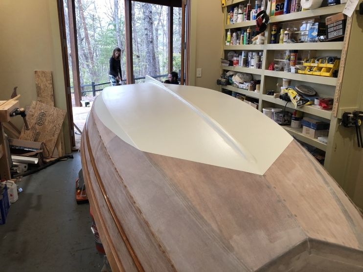

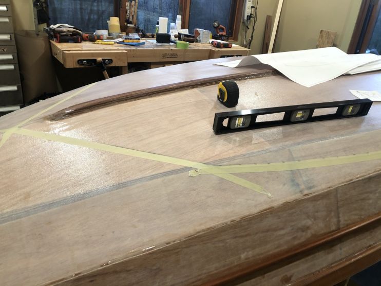

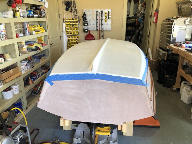

      While the boat was upside down, I went ahead and gave it 3 coats of anti-fouling paint. Getting it done where it is at a nice working height, not paint dripping into your mouth or eyes., etc.
      I used a basic laser level to strike a line and used fine line tape to mask it off. I then added wider tape to provide nice comfortable margin to keep from slopping paint everywhere. I,hope the boat will sit nicely in the water.
