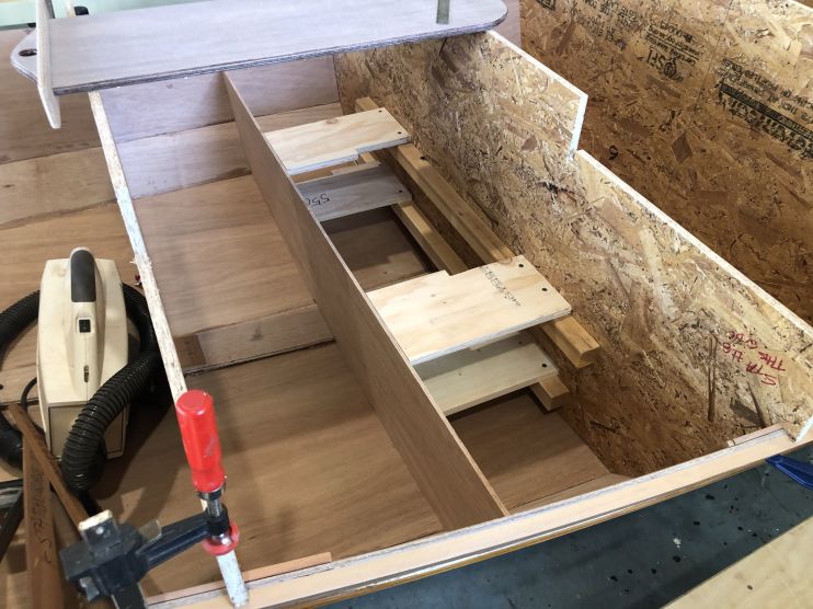

Doug HermannParticipantI have pre-made the jigs to align and hold bulkheads in place for epoxy.

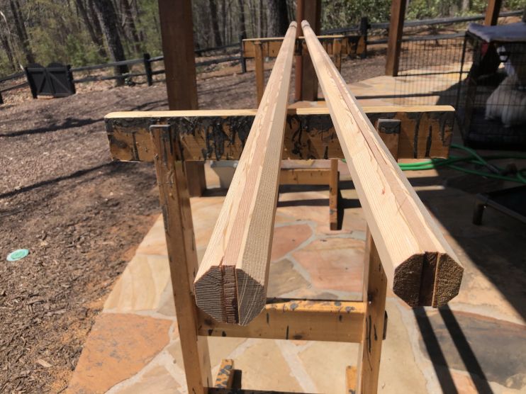

Doug HermannParticipantGluing up the two spars. Douglas fir and cedar accent. Cut down to octagon. Sanding jig using 2” PVC pipe. Bought pipe at Home Depot. Sticky roll sandpaper. It works beautifully.

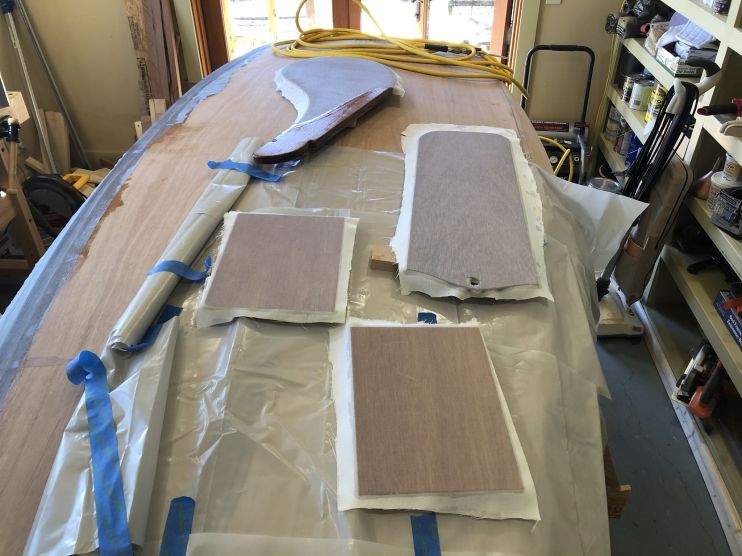

Other bits and pieces being shaped, formed, epoxied.

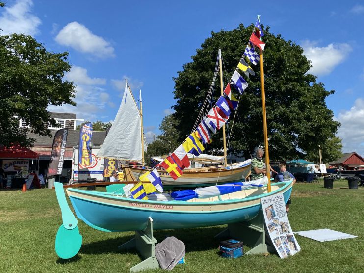

Richard HonanParticipantGood afternoon, Doug! We met a little over a week ago at the WoodenBoat Show in Mystic Seaport. I’m the guy with light blue and green 13’00” Peapod (with the flags). Our little talk we had on Saturday got me thinking about my agility and Oonagh’s stability. I just ordered the plans and am looking forward to build number thirteen.
