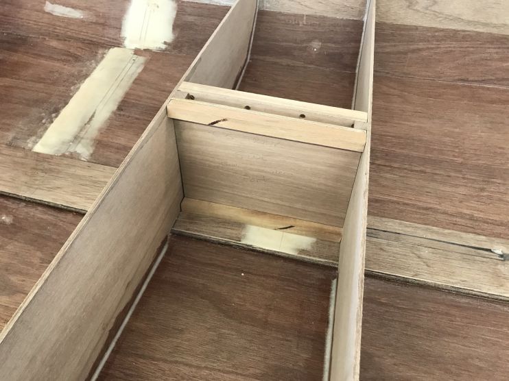

      4/8/21 – Decided to finish installing partitions before tackling the daggerboard trunk. The center seat partitions are done.
      IMG_3014
      The daggerboard trunk is dry-fit.

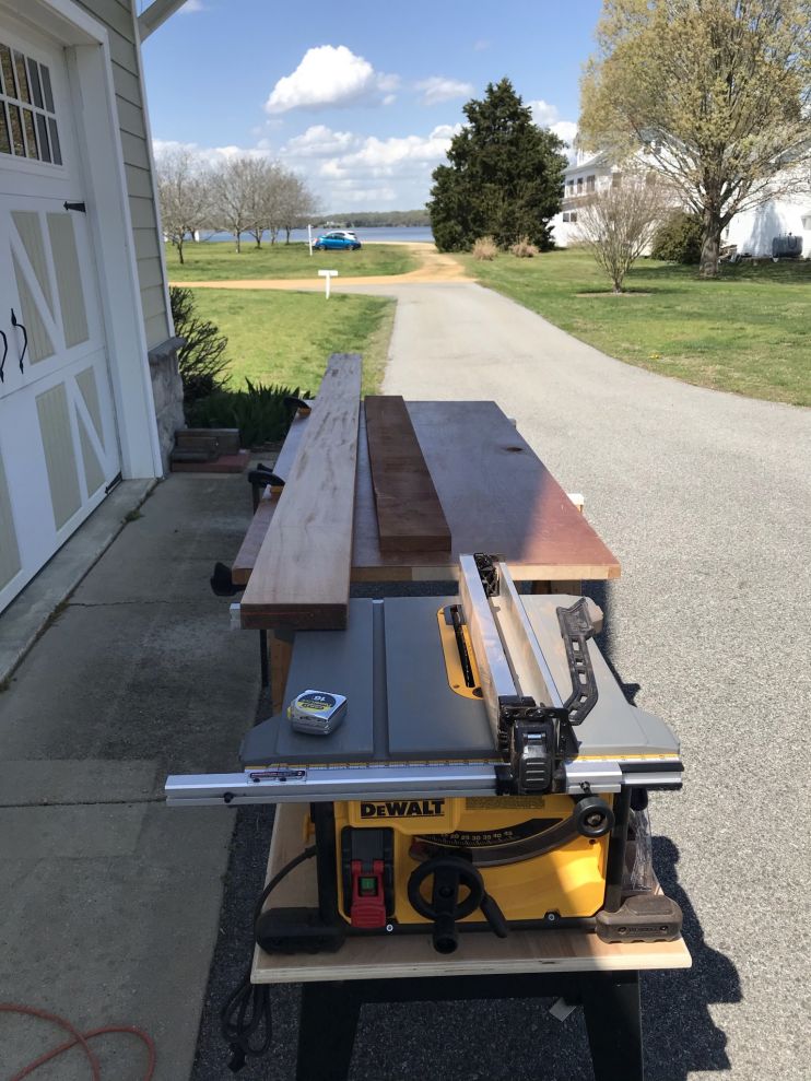

      I spent the afternoon milling the 4 – 1/2″ inwale pieces and the various seat supports and daggerboard parts from a solid block of mahogany.
      IMG_3087
      The darker piece is Africa mahogany. The other is mahogany of unknown parentage.
      The 13′ long piece of mahogany was much heavier than my table saw and stand and you can see from the video the weight of the wood was trying to tip over the saw.
      Shaky Table Saw
      In the end, I was able to get the pieces I need to finish up the seats, daggerboard trunk, and inwales.

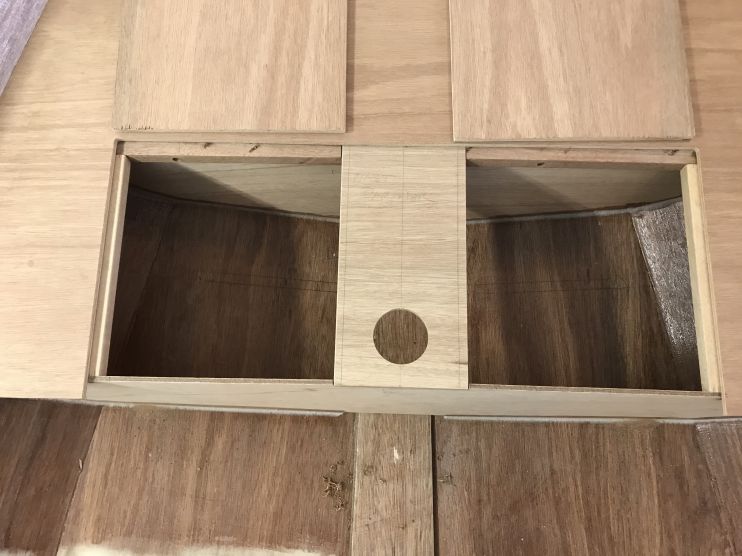

      4/12/21 – Still working on the bow seats & supports. The mast partner is integral to the seat. It has to be inset into both partitions and the brace across the middle. I used my router to remove 1/2″ of material from all points that it touches. There is also a 6-degree slope to the cross brace or it won’t lay flat.
      IMG_3096

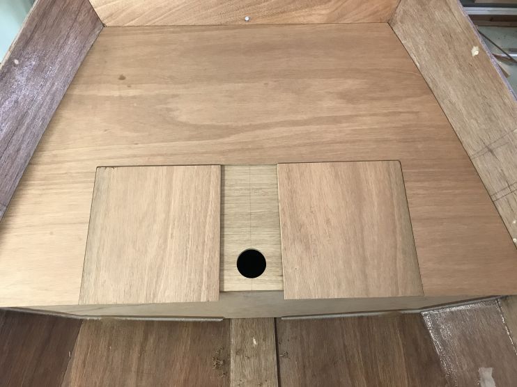

      After the mast partner is fit, I was able to dry-fit the seat tops to determine where the hatches land and where to drill the hole in the covering panel.
      IMG_3099
      Once I got the hatches in the right place, I was able to draw lines on the mast partner for where the covering panel goes. I then positioned the panel on top of the mast partner and used the hole in the partner to draw a corresponding mark on the panel, then cut it out with a 2 1/2″ hole saw.

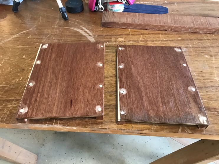

      4/13/21 – Finished the overhang on the two hatches. Nothing is glued yet because I ran out of adhesive thickener. New orders should arrive today.
      IMG_3105

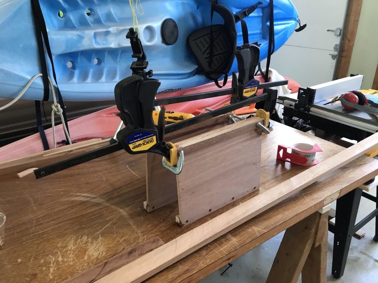

      Because the daggerboard trunk is going to be wet whenever the boat is in the water, I need to make sure it is completely impregnated with epoxy. It may take me several days to fill the screw holes and apply at least two coats of epoxy to the inside of the trunk before gluing everything together. Meanwhile, I will keep working on the center seat supports and clean up the interior of the compartments for priming.

      I finished up today putting a coat of epoxy on the daggerboard trunk.
      IMG_3127
      And filling the screw holes that will be inside the trunk. I need to fill those holes before I can start applying two coats of epoxy on the inside face.
