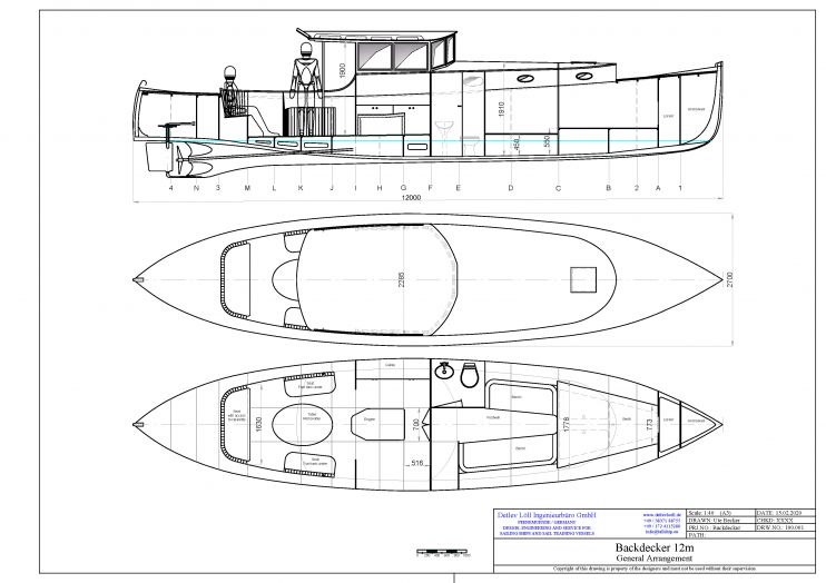

      I did buy the plans of AROHA, as i did like the boats design. Looking at them and the videos i liked the possible performance, but i did not like the missing bulkhead at the aft end of the cabin and the limited space at the steering position. Therefore i decided to enlarge the design.
      After some work i have now at larger version, 12 m long, 2,7 m beam. A cabin with a double berth, two benches, separated washroom, larger steering position with outside galley at portside. Engine now a 120 hp 6 cyl. Mercedes Benz diesel. The boat is under construction at the company Boat-Workshop Gmbh here in Peenemuende, in the far northeast of Germany.
      To myself, i am 61 years old, mastercraftsman of boatbuilding since 1987, steel shipbuilder, specialised in tallship rigging designs and building, like Gorch Fock, Sea Cloud II, BIMA Suci and others
      GA_15.02-GA_A3

      This is a much improved plan from the original. It makes the boat more usable where the original plan is more of an art work piece.
