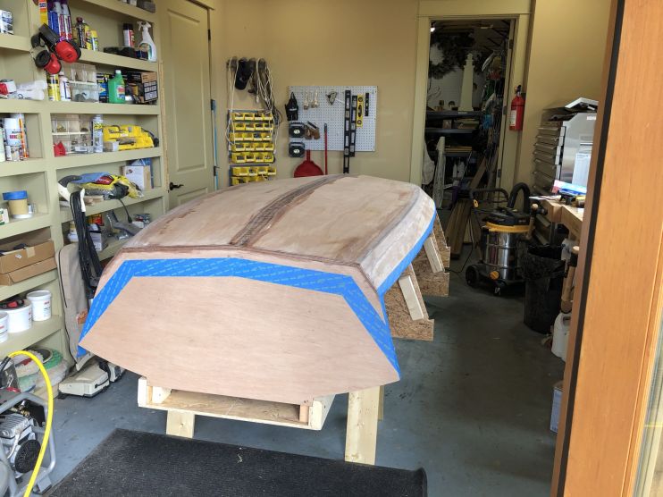

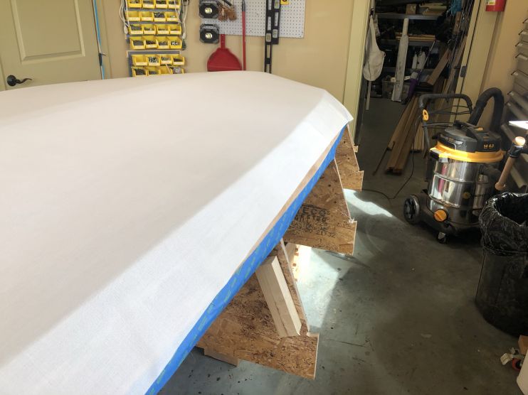

      I taped off the prepped hull.Laid out the dynel and trimmed it to fit. Saturated the cloth using a roller. Came out very nice and smooth. A little scraping the next morning, a little sanding with random orbit finish sander, all good to go.
      I ended up applying 6 oz cloth to the sheer panel and I applied dynel to the exterior of bow and stern.
