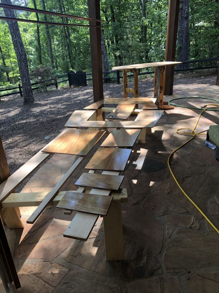

Getting the final coats of epoxy on all the loose pieces inside the boat and on the interior. Today was a marvelously warm and sunny day. The epoxy flowed like cream. Next up will be sanding and fairing, then either finish coats or a couple of coats of primer first. I confirmed with Kirby Paints a primer coat isn’t necessary when applied to MAS epoxy. There is no amine blush with MAS. So we will see how things look and how “perfect” of a finish am I really capable of producing.
AT LEAST 2 COATS OF EPOXY ON ALL EXPOSED SURFACES.
EPOXY STATION SETUP AND LOOSE PIECES LAID OUT READY TO BE COATED

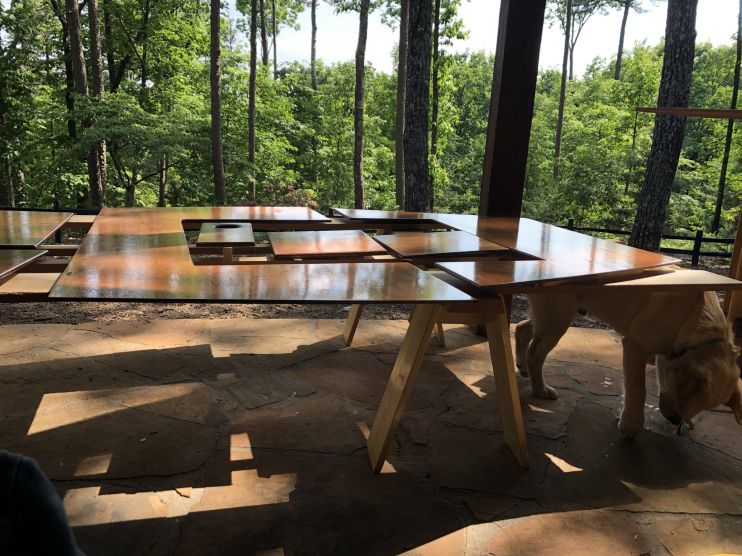

NICE SHINY AND SMOOTH FINISH. PREPPING FOR PAINT SHOULD BE EASY.
