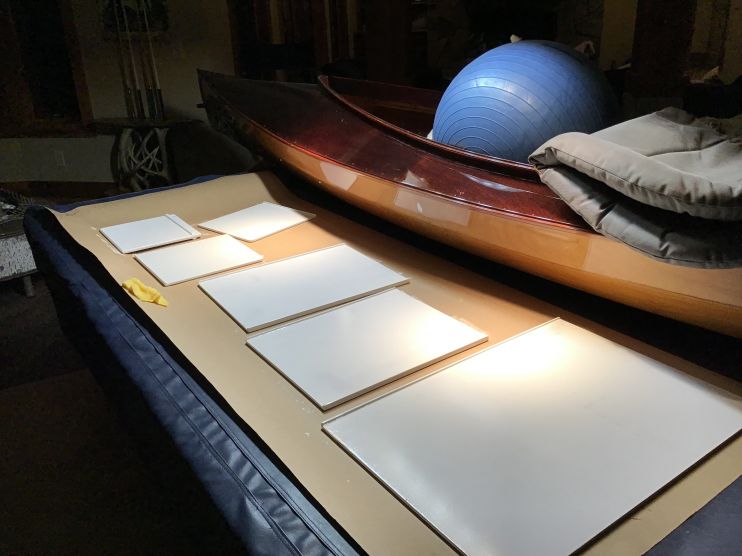

I also put the 1st finish coat on the undersides of the hatches. I am a lousy painter and I am trying to mix in some Penetrol to the finish coats and really try to get a nice finish. Rolling and tipping is the approach. Penetrol seems good will experiment some more on the hatches before tackling the cockpit or hull.

Hatch covers, bottom-side getting RustOleum gloss white paint. Exterior/topside will be Kirby paint..
