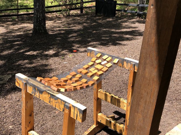

I had cut out 48 2” spacer blocks. Now it is time to coat them with epoxy. How do do it as they are small and slippery when wet? Then how to set them aside for epoxy to setup?
I remembered I had some left over screen material, stapled it across two sawhorses and presto – simple place for the blocks to set up. Worked great, nothing sticked.
I ended up coating the epoxy by hand. Had on gloves and it made quick work versus roller or brush.
