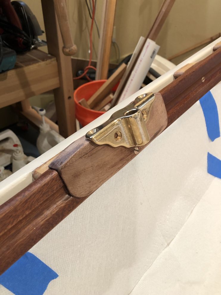

I finished up the final shaping and then screwed and epoxied the pillow blocks onto the newly installed inwale. These will be finished bright with bronze oarlocks. I will do the same process, multiple coats of gloss, then a few coat soft satin varnish.

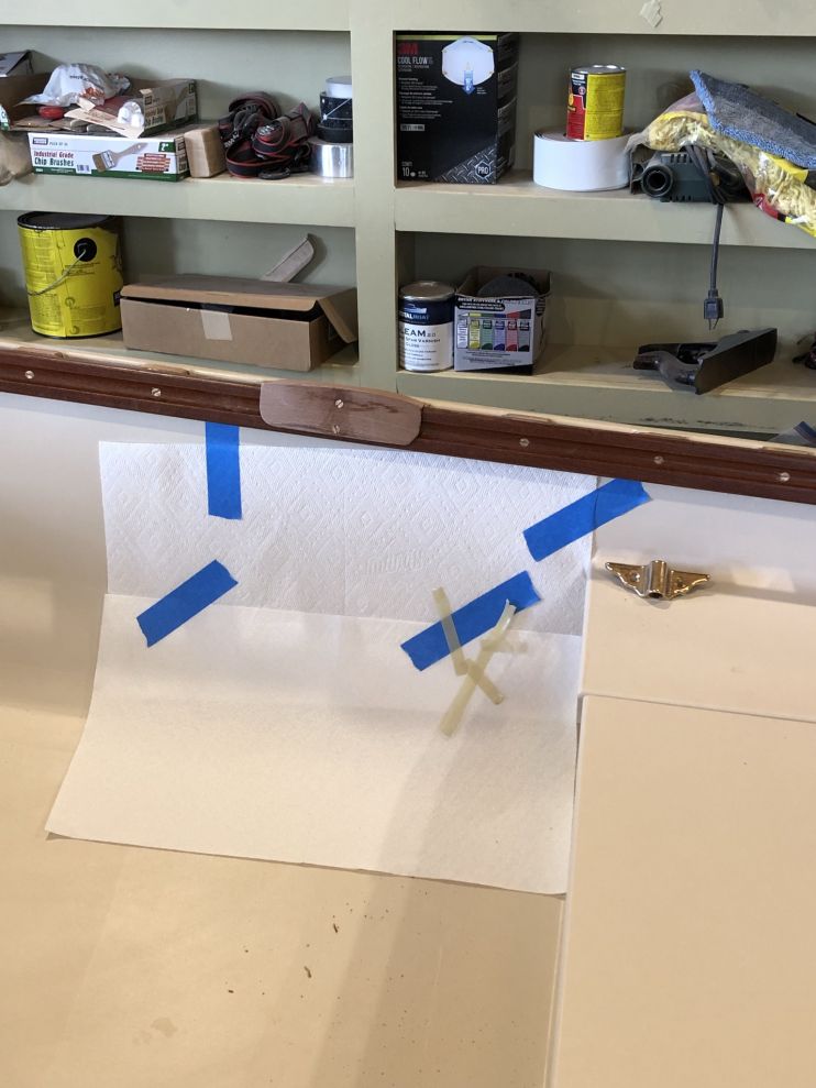

The paper towels were taped in place to catch any epoxy squeeze-out and anything else falling from above. Just trying to keep freshly painted interior pristine.
