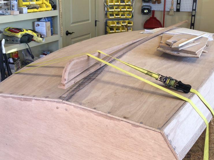

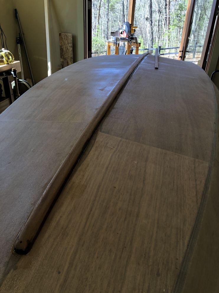

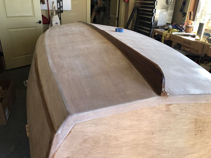

      I don’t have much the way in photos of the shaping and making template for keel. But here is what I do have:
      Dry fitting
      Runner in place
      Keel in place
      I did screw from the inside to secure the assembly while epoxy cured. I did leave the screws in. Used a 4″ deck lag screw to really pull the keel in tight.
