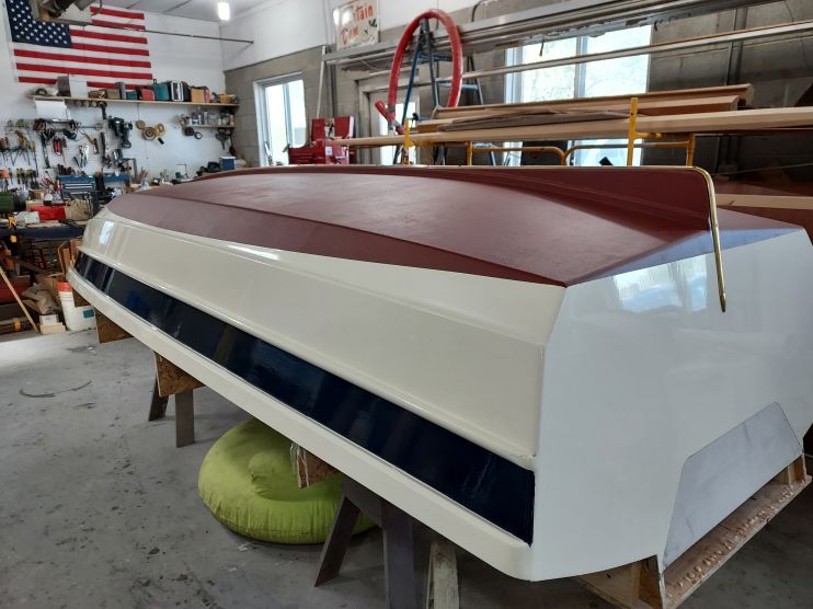

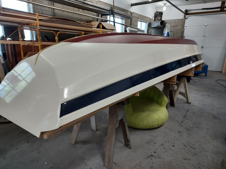

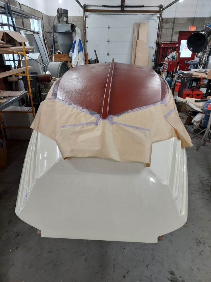

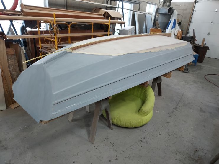

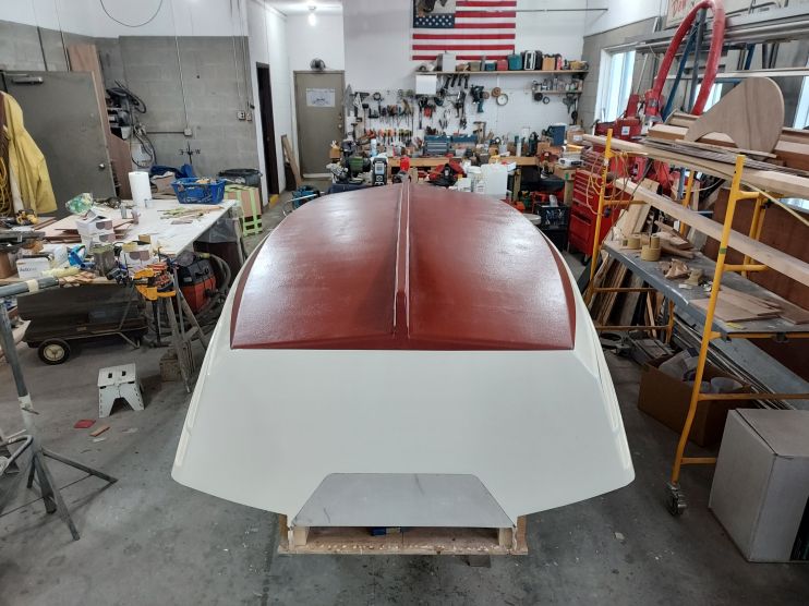

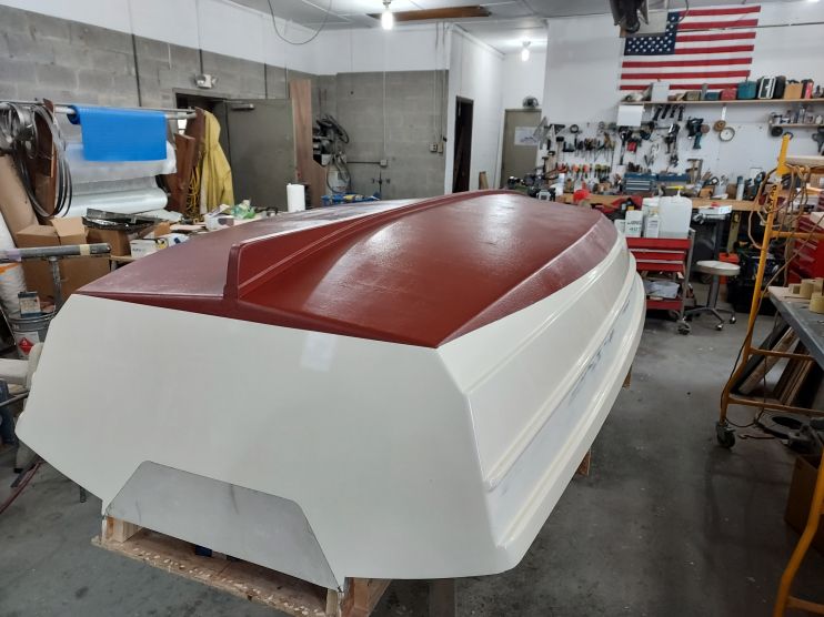

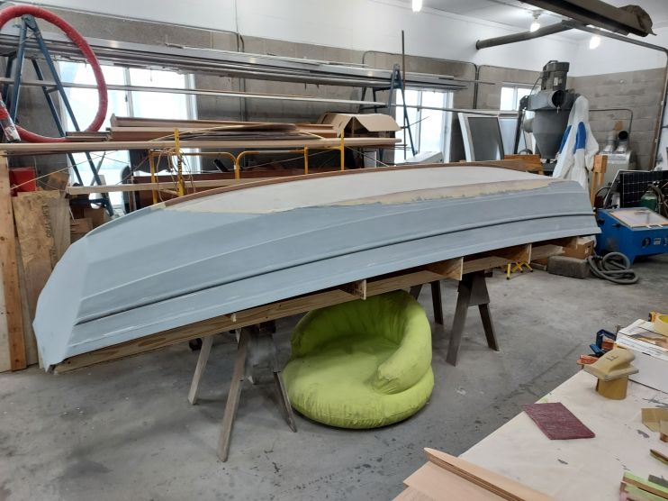

Home › Forums › 11′ 10″ ARRIBA / OONAGH Dinghy – Official Step-by-Step Boatbuilders’ Forum › ARRIBA / OONAGH – 12b – Thoughts on Paint › Painting the exterior This topic has 0 replies, 1 voice, and was last updated 3 years, 6 months ago by Fred Probst. Viewing 0 reply threads Author Posts January 12, 2023 at 7:30 pm #47457 Fred ProbstParticipant Brightside Hatteras off white 1990 and flag blue stripe over 545 epoxy primer. Bottom is inter protect and Trinidad pro. Author Posts Viewing 0 reply threads You must be logged in to reply to this topic. Log In Username: Password: Keep me signed in Log In
