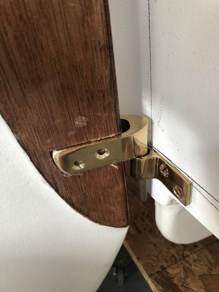

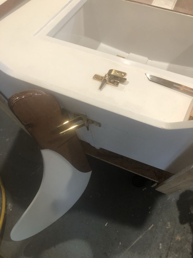

Doug HermannParticipantI have dry fitted the pintles and gudgeons. The rudder needed a little cutting/chiseling to get a nice tight fit. The lower pintle needed to be trimmed back which I did on the bandsaw, followed with some filing work. Everything looks good, the rudder is aligned vertically on the stern center line. After exterior hull is painted, will re-attach hardware and bed with either 4200 or 5200.
