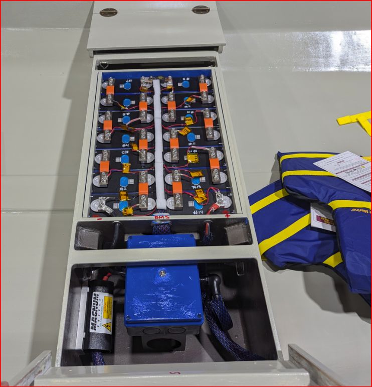

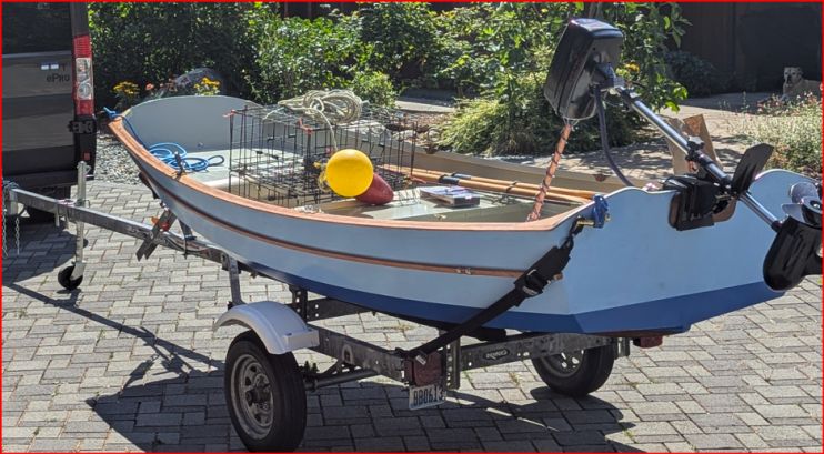

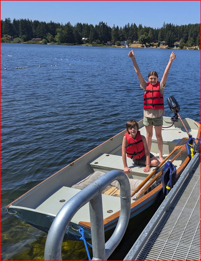

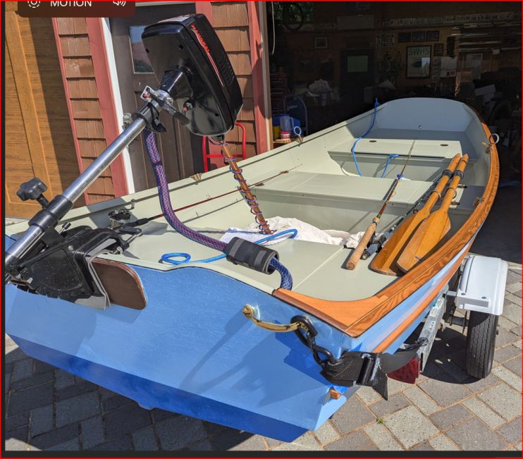

      Just launched this summer, yet to have a name, but the boat will tell us when it’s ready. I did think of PIOTIO, as in Put It On, Take It Off, which in my case describes the building (from plans) method. But we shall see. Right now it’s powered by a 2200W electric motor and 14-280 ah lithium iron phosphate batteries. So far we have been on fresh and salt water, with a successful crab trip last outing. This is a sweet boat, super stable with the weight in the middle down low, even in choppy water.boat1

      WOW That looks like a super grunty power house there. Well done.

      Thanks John, my idea was to have a nice little eboat that could be also a good work boat for fishing and for many hours exploring Salish Sea. I think it worked out ok!
