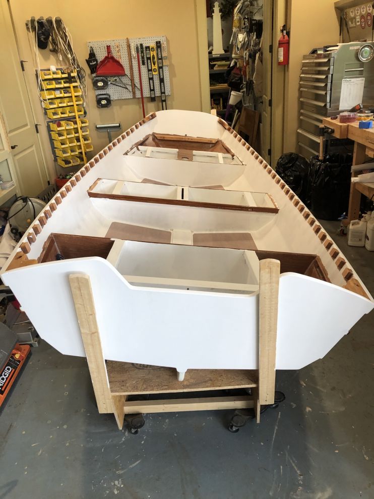

      I got a primer coat on all exposed surfaces on the interior of the boat. I was debating about primer vs no primer. I have 2 qts of primer on hand, so I used it. Can’t hurt, perhaps a little overkill. Perhaps 3 more days added to build schedule.
      the cockpit floors are covered in Dynel, they already have a couple of coats of epoxy. Want it to be a bit of a non-slip surface, so am skipping primer on those areas.
      Just a few more steps and thwarts can be finally epoxied in place.
      AB17FCD1-1FAA-4F8E-BE11-6C16F66770B0
      THE BOSS WANTS ALL 48 spacer blocks to be finished bright.
