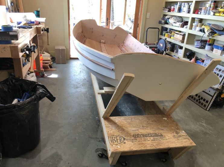

When I pulled the hull off the molds, I flipped the ladder frame upside down as well. Sat the boat on that. I used some simple scrap,pieces to clamp,off at the bow and stern to hold the boat level, side to side when needed.
once the station molds go back in – leveling the boat fore and aft is very easy.

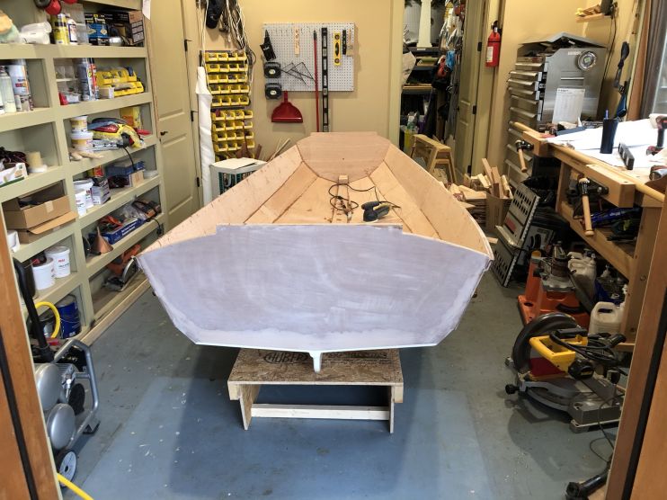

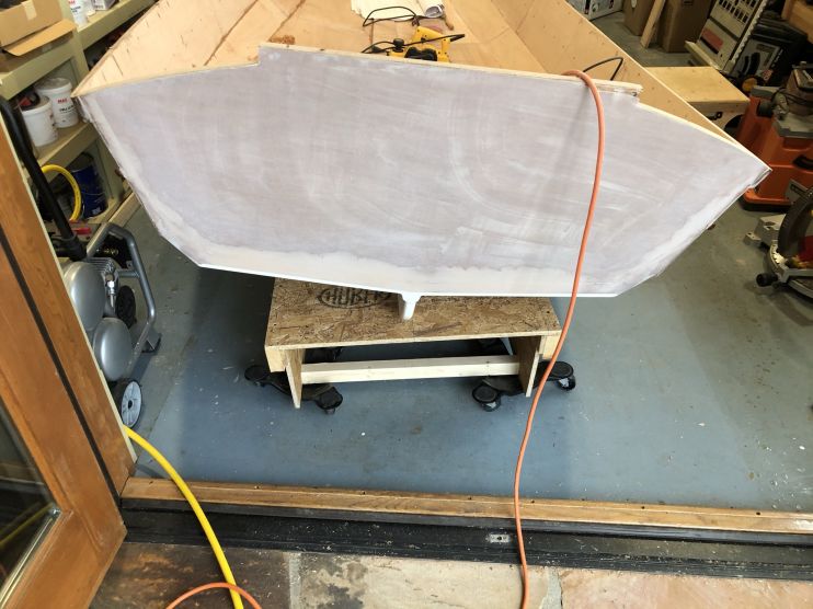

I also placed 4 furniture moving dollies under each of the corners. I can now easily move the boat about. I have very limited space and these make moving around much much easier. I don’t think I have great pictures of the dollies, so I will try to remember to take some in the next day or so.
Here you can see two scraps I use to clamp to bow and stern to hold the boat from rocking
