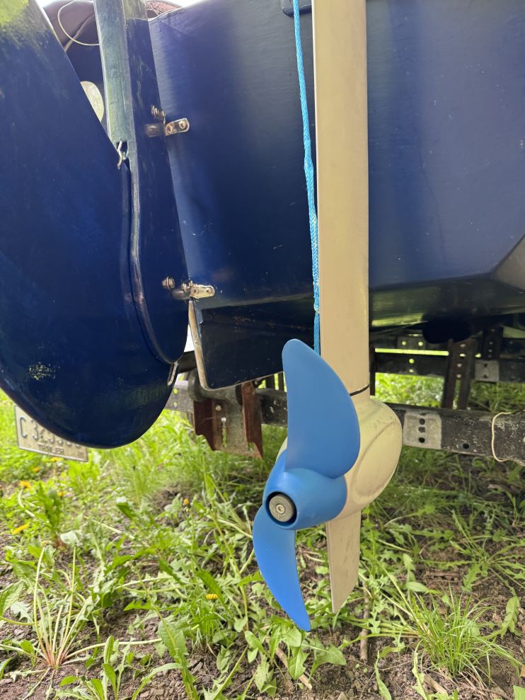

I made a kick up rudder last winter so I can leave it attached while motoring. The boat was already flipped so wasn’t able to prototype properly and based it off propeller scuff marks on the original rudder. I should have made the pivot point a bit higher. It stays out of the way unless I go into reverse and rudder gets pushed closer to the transom.

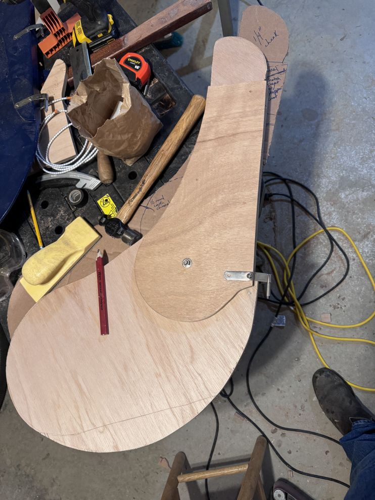

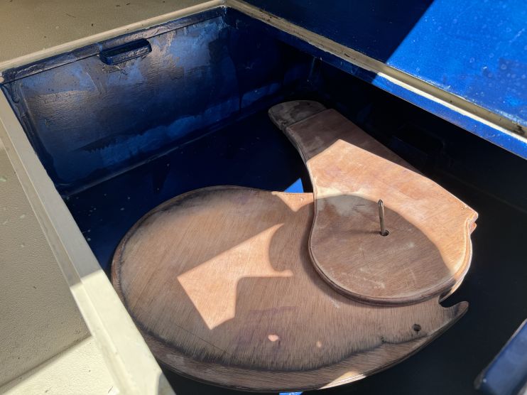

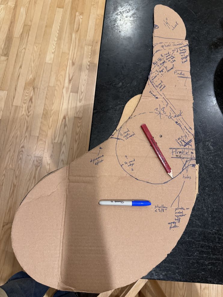

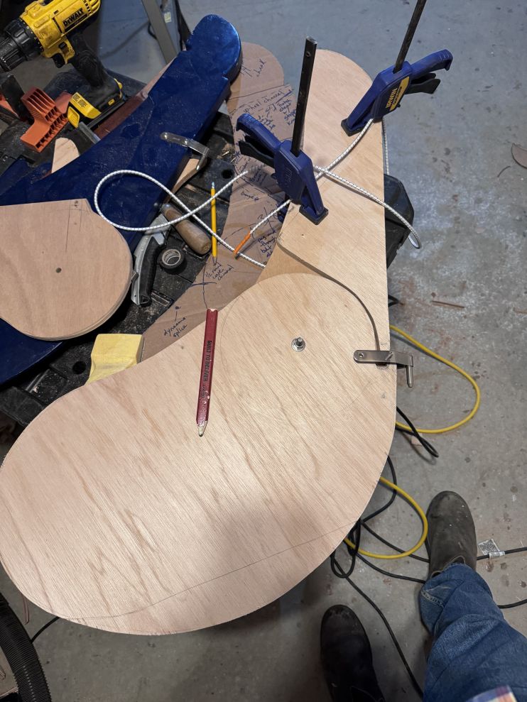

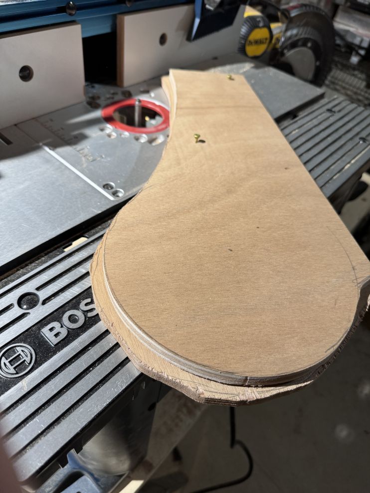

ParticipantHere are a few pictures of the kick up rudder.
November 20, 2024 at 12:48 pm #51594
Ted Guild
As you can see, it can stow in the stern compartment unlike the original rudder.A few inches higher on the pivot point would have been better. As mentioned the boat was already flipped and covered so couldn’t really try a cardboard mockup with engine attached. I may make another this winter.
Screwing together mirror pieces like the cheeks on the rudder is a great aid in getting them the same on router.
