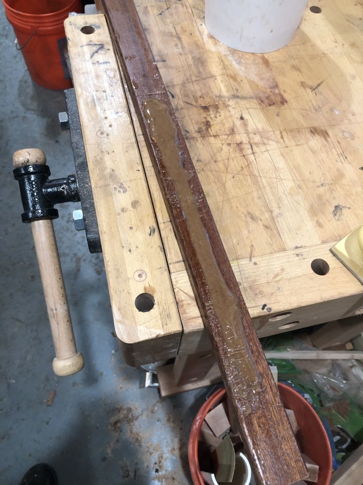

      THE THICKENED EPOXY SET AND READY TO BE SANDED SMOOTH
      508FD341-A13F-4EA1-84CF-99D4D807CC68

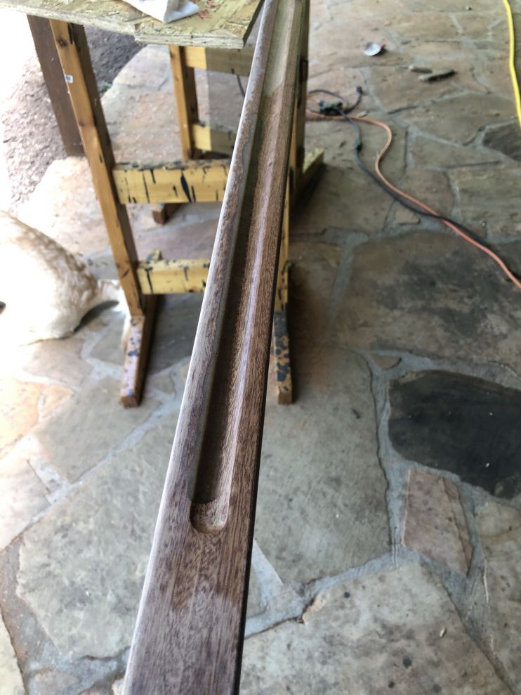

      DECORATIVE GROOVE
      3E665964-FEB0-49FF-8D27-2509855A8A0E

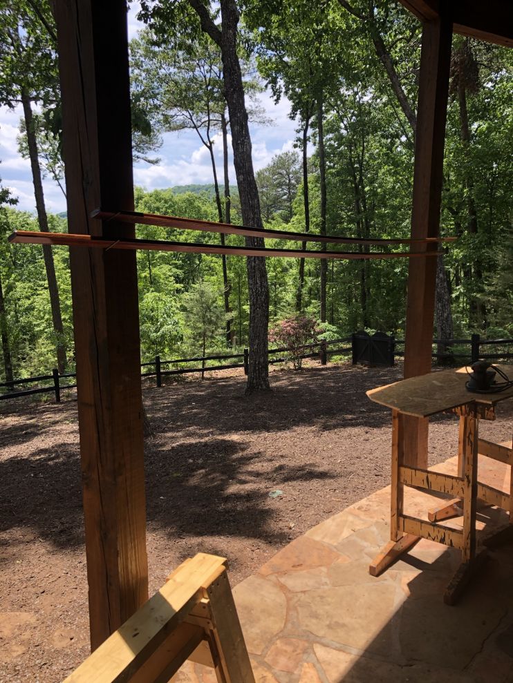

      THE INWALES EPOXIED AND SITTING IN THE MORNING SUN CURING AWAY
      4C4BBF5E-4622-400E-8354-1A9611BA5985

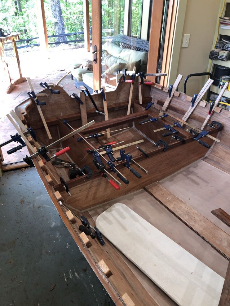

      STERN THWART –  ALL PIECES EPOXIED IN PLACE
      C8046763-0383-4FB8-93EB-42B1671D4CB5
