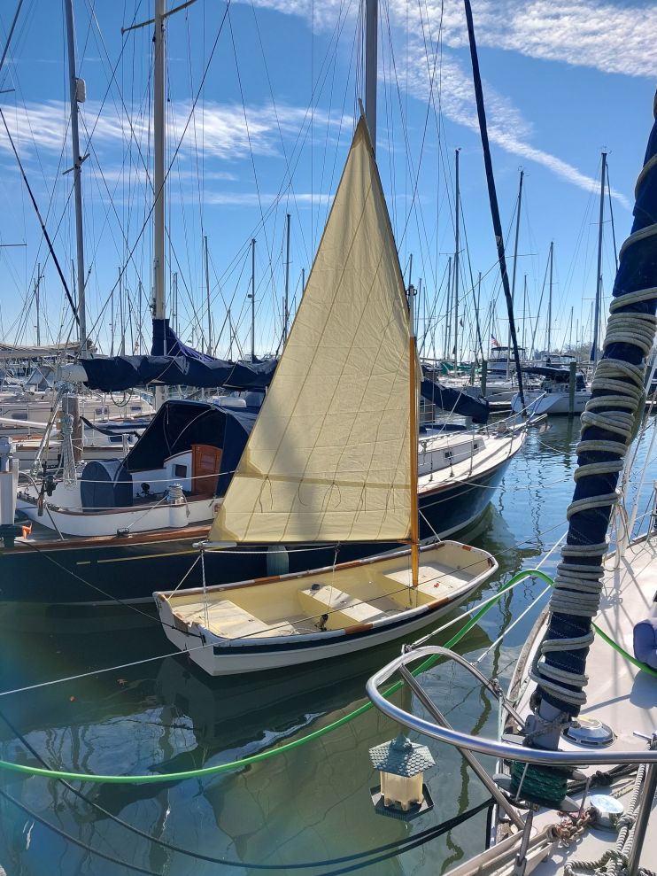

      A few more bits and bobs and we can call this build complete.
      Boat
      20231104_17052620231104_11450220231105_073553

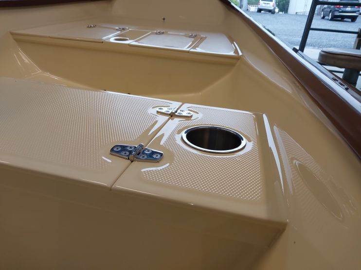

      What did you use for the grey non-slip on the sole?
      • #49151
        Fred ProbstFred Probst
        Thanks! The non skid is gibco ‘redeck’,  then painted with awlgrip with  medium griptex, and two coats of straight paint on top. It is an INCREDIBLY grippy surface that gives great confidence when standing up.
        20230623_15470620230304_15414478 50w20230706_213752he same same non skid that is applied to $10m Weaver sport fish.
