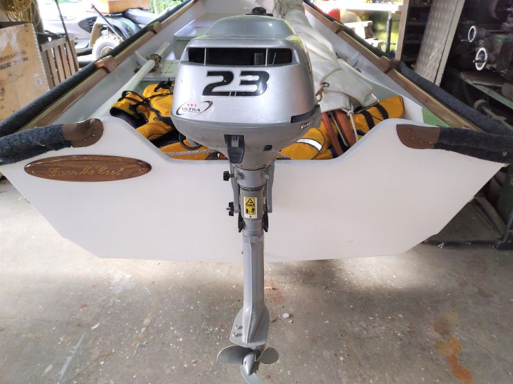

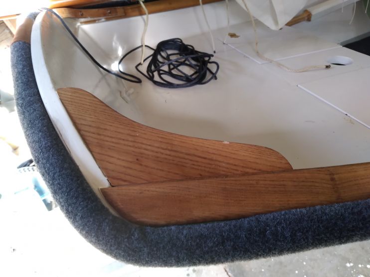

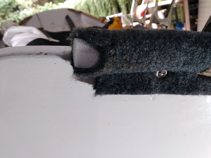

    Hi All, thanks for the supportive comments Doug, and yes I have just got the product back from the saddlers and I think it looks fine, except for the colour.   It is a little fiddly to fasten to the gunnel as I don’t have enough hands! 20210730_150819

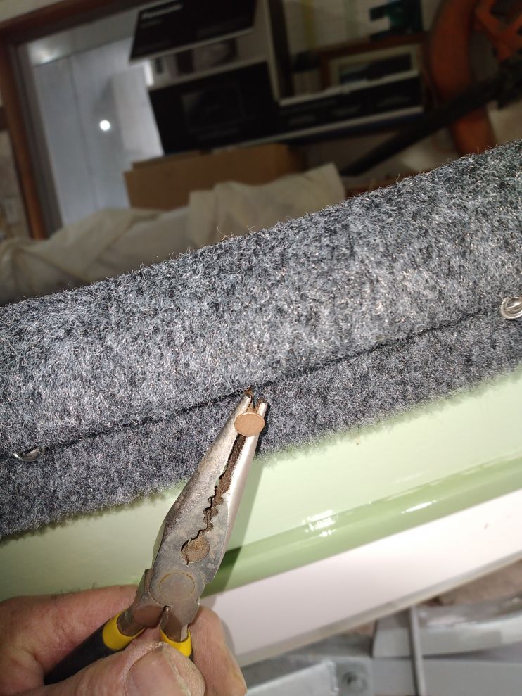

    However it has attached firmly and I think it has perfectly enough cushioning to work well as a fender against another hull. As I didn’t have enough screw and cup washers, I fitted a 3/4 inch copper flat head nail in between the screw and it doesn’t stand out as too much fixings. The screws I placed at 6 in Centres so it’s fastened every 3 in. After wacking my fingers a few times, the light bulb went off and I used a pair of pointed nose pliers to grip the nail as I drove it with the hammer.20210730_114956

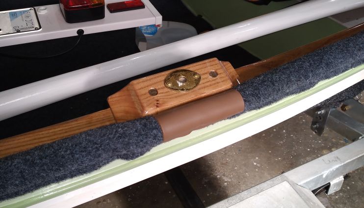

    As the carpet was only 6 ft wide I had the saddler make it in short lengths with the joins placed under the leathers at the oarlocks and mid bow transom. It made it very manageable in short lengths.
    20210730_150851 (2)
    I think the leather protection under the oarlocks is a splendid idea serving a double purpose in my case.
    20210730_151051

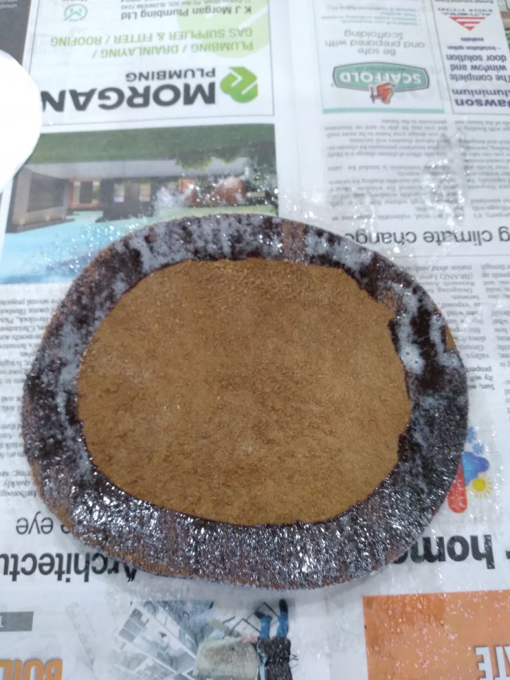

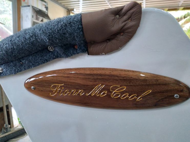

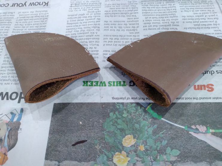

    The fender folded around the bow & stern quarters really nice and I took it up almost to the engine well drop at the stern transom. The leathers here caused me some angst thinking how to fit them until I slept on it. I cut an obround, then a paper circle to place on top of the leather, then I sprayed contact glue on the exposed outer rim of the leather.  I then folded the leather over like a pastry clamping the two halves together until set,  then cut the half circle  into two halves.
    20210730_095832
    20210730_095949
    20210730_102213
    This left a nice handy little pocket into which I could slip the fender rod and carpet into. It saved a lot of fiddling trying to fold over the top flap of leather while trying to fasten it in place at the same time.   Rather than have a blunt end to the fender I tapered it a little before sliding the leather pocket over the end of the fender. Once sure of the position I used a spring clamp to secure it while fastening it in place with some flat head copper nails.
    20210730_110745
    20210730_103336
    20210730_150911 (2)
    All in all I am delighted with the end product considering nothing like this is available here in New Zealand. Cost wise It was NZ$28 for the poly rod, $29 for the carpet, $75 to be stitched up with Dyeema stitching and $35 for the leather… total of NZ$167.00   probably equivilent to about US$4.25!!
